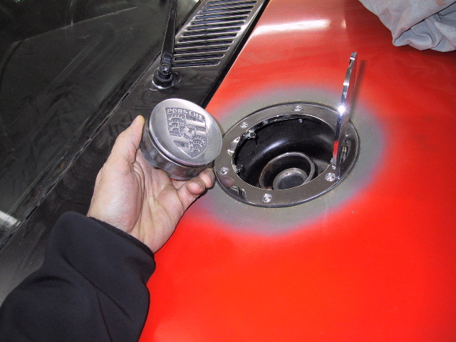

> Metal shapers, How do you roll the edge, of a 3" hole for an exposed gas cap?

I topped off the stock cap with a wheel centercap.

iamchappy   This is how mine looks with the door open.   Dec 16 2005, 04:05 PM
neo914-6   Nice touch, how about a clear door? ...   Dec 16 2005, 05:29 PM
neo914-6   ...   Dec 16 2005, 06:51 PM
