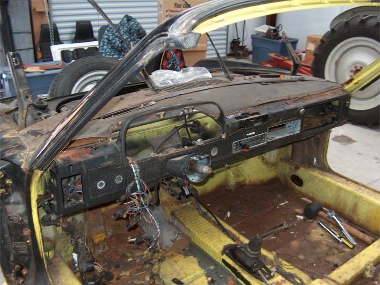

Well, I'm in the process of dismantling one of my parts car and I've decided to document the steps used to remove the dash top.
I began removing the top dash pad by removing the instrument cluster. If you haven't removed the steering wheel and knee pad, do that now. Next, remove the 4 screws that hold the cluster to the dash. Now, just pull the cluster forward, without removing the electrical connections. I have removed the cluster completely from the car because I'm stripping it. You don't have to do this to remove the dash top.

well, i used this thread, and it worked great!! Since i am completely stripping this car, i decided to add to your thread, and remove the dash frame under it. it only took me about an hour. first, you need to remove all of the switches, the steering wheel, and disconnect all the other electrical connections, and pull them down below
With the steering wheel off, and the switches pull out of the back
