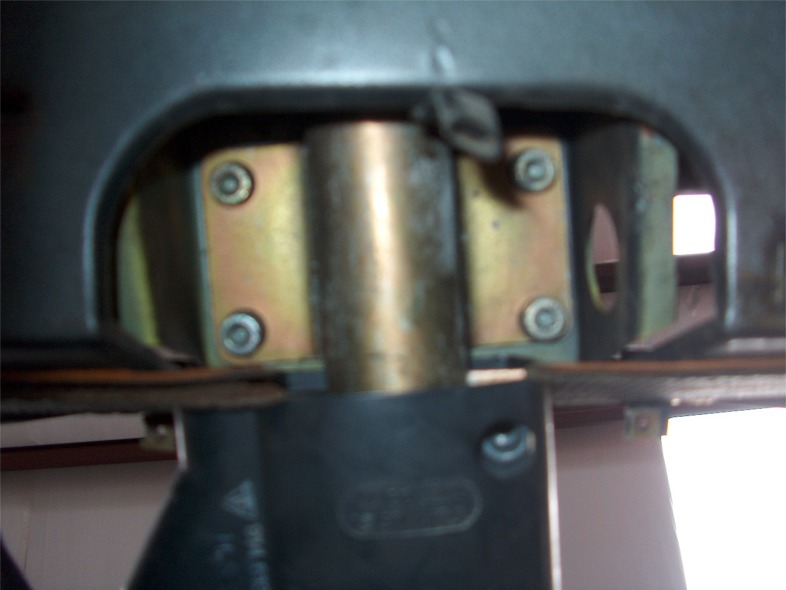

next, remove the fresh air control unit in the dash. There are two ...8mm? nuts holding the cables to it, and a 10mm nut holding it to the body. Pull it out the front. Next, remove the steering column: there are four 7mm allen bolts holding it to the body

grasshopper   disconnect the universal joint: 13mm bolt, and 14m...   Dec 18 2005, 07:00 PM
grasshopper   with it removed:   Dec 18 2005, 07:02 PM
