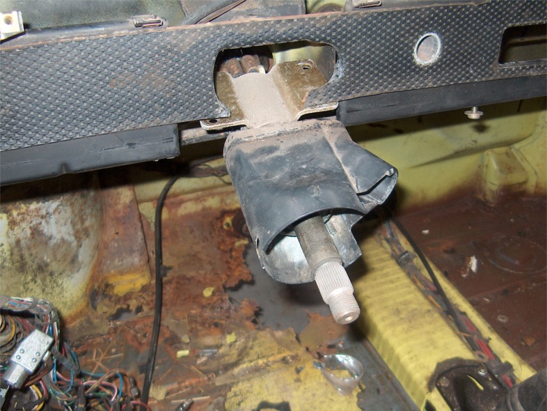

grasshopper   disconnect the universal joint: 13mm bolt, and 14m...   Dec 18 2005, 07:00 PM
grasshopper   with it removed:   Dec 18 2005, 07:02 PM
