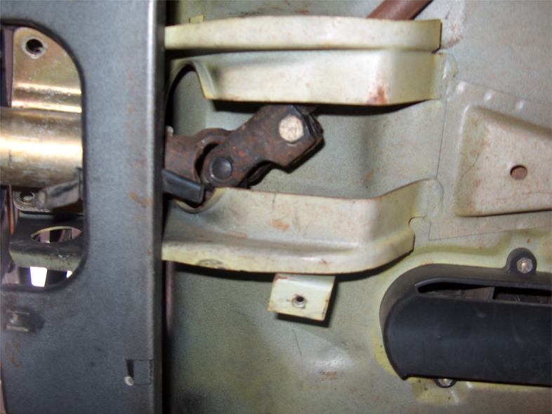

disconnect the universal joint: 13mm bolt, and 14mm nut
