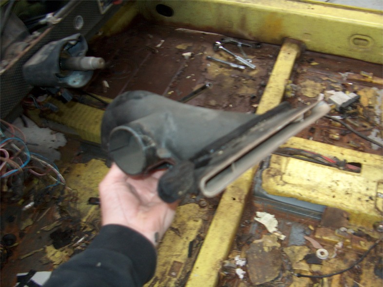

next, remove the two upped dash vents. They seperate from the larger units in the front trunk, with two clips. Push them up a little, and pull them down and toward the front of the car. The drivers side can be a little tight, but it is possible with the gas tank in...i did it, you just have to wiggle it around alot. With it out
