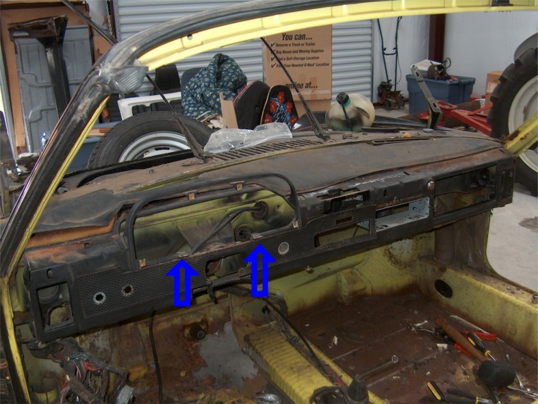

now your dash should look like this, you need to remove the two screws pointed out here, too. I would have missed that, but michel reminded me

michel richard   Are'nt there 6 screws that hold the instrument...   Dec 18 2005, 07:21 PM
grasshopper   the other two nuts are in the same places on the o...   Dec 18 2005, 07:22 PM
grasshopper   thanks for reminding me about that michel, those w...   Dec 18 2005, 07:25 PM
