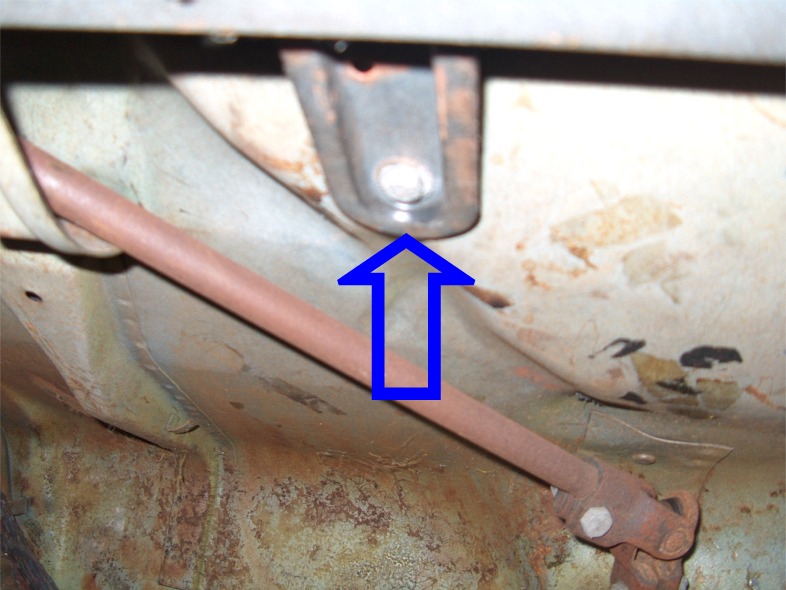

remove the 10mm nut under the dash, connecting the dash frame to the body. This nut isn't hidden, it is right in the middle, but this is a bad pic.
