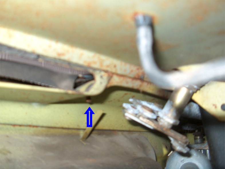

the next nut is about 8-10 more inches down the dash... you just have to feel for it, because you wont be able to see it. It is 10mm also... a bad pic of it:
