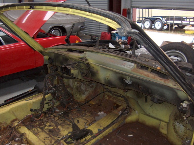

thanks for reminding me about that michel, those were removed when i got the car, but i noticed them when the dash frame was out. i will edit my post.
with car with the dash frame out

grasshopper   well, i used this thread, and it worked great...   Dec 18 2005, 06:52 PM
grasshopper   next, remove the fresh air control unit in the das...   Dec 18 2005, 06:57 PM
grasshopper   with the nuts out   Dec 18 2005, 06:58 PM
grasshopper   disconnect the universal joint: 13mm bolt, and 14m...   Dec 18 2005, 07:00 PM
grasshopper   with it removed:   Dec 18 2005, 07:02 PM
grasshopper   next, remove the two upped dash vents. They sepera...   Dec 18 2005, 07:06 PM
grasshopper   next, remove the two screws on each side of the da...   Dec 18 2005, 07:08 PM
grasshopper   now your dash should look like this, you need to r...   Dec 18 2005, 07:10 PM
grasshopper   remove the 10mm nut under the dash, connecting the...   Dec 18 2005, 07:12 PM
grasshopper   now there are only four more nuts holding the dash...   Dec 18 2005, 07:17 PM
grasshopper   the next nut is about 8-10 more inches down the da...   Dec 18 2005, 07:20 PM
michel richard   Are'nt there 6 screws that hold the instrument...   Dec 18 2005, 07:21 PM
grasshopper   the other two nuts are in the same places on the o...   Dec 18 2005, 07:22 PM
grasshopper   still a few things on the frame itself   Dec 18 2005, 07:27 PM
grasshopper   the stripped dash frame   Dec 18 2005, 07:28 PM
grasshopper   thats all http://www.914world.com/b...   Dec 18 2005, 07:28 PM
