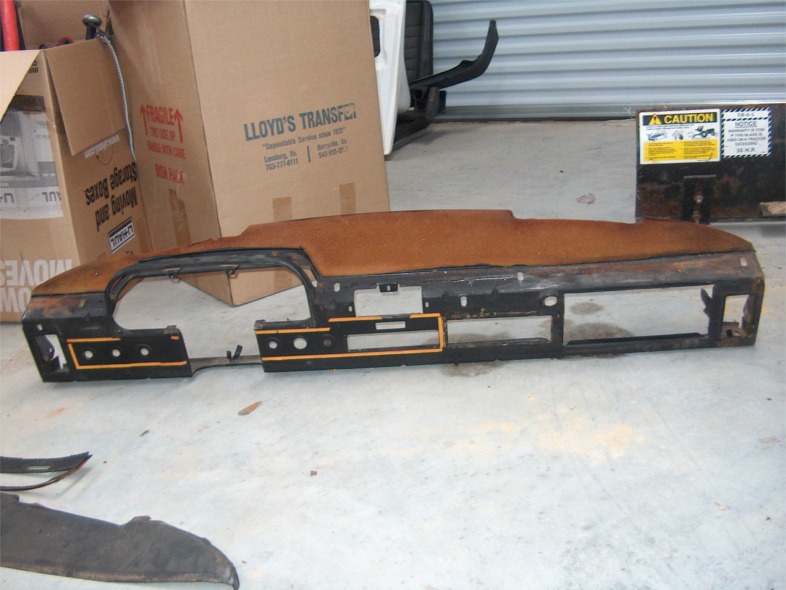

the stripped dash frame

grasshopper   still a few things on the frame itself   Dec 18 2005, 07:27 PM
grasshopper   the stripped dash frame   Dec 18 2005, 07:28 PM
grasshopper   thats all http://www.914world.com/b...   Dec 18 2005, 07:28 PM
