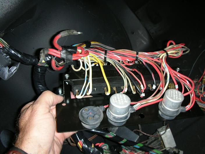

Sound deadning for undercoat. Forgot to look at brand name.
12/23 Installed Engman fuse panel, back side pic.
