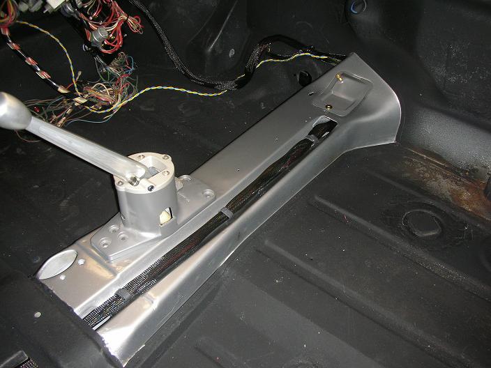

post Dec 23 2005, 08:10 PM
Actual member 7"
Posts: 695
Joined: 22-November 04
From: Huntington Beach, Ca.
Member No.: 3,165
12/23 Center tunnel wiring loom finished. Tunnel painted to match outside of car, will remain exposed like shown.
