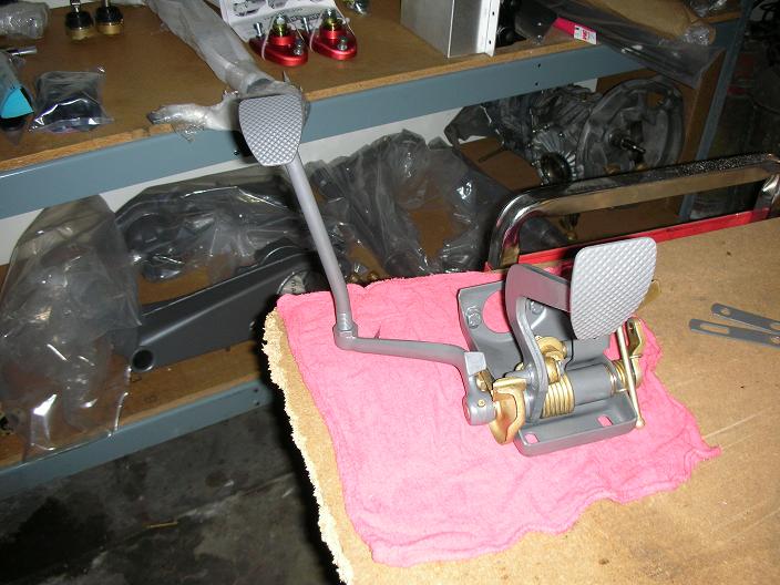

12/31/2005 Got some good work done, cut several holes in the car for oil lines, modified fuel cell & rubber mounts, finished fabricating rubber mount oil cooler bracket plate.
Pedals assembled, they look wicked! BTW anybody know what those two bracket pieces are on the right? I had them powder coated for some reason, now I don't remember where they go.
Happy New Year all.

Aaron Cox   the bracket things look like the ones on the rear ...   Jan 1 2006, 02:20 PM
