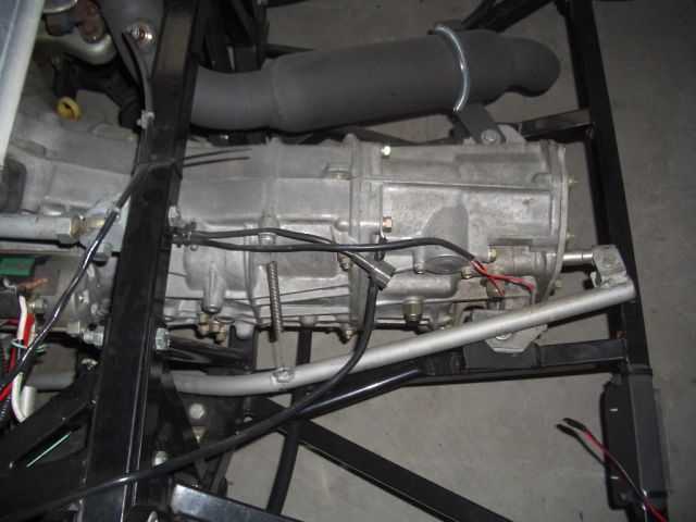

here is a view that might help, not a 914 but an approach

d914   here is a view that might help, not a 914 but an a...   Jan 2 2006, 09:16 PM
Porcharu   That's exactly what I am thinking along the li...   Jan 2 2006, 09:39 PM
guiltless   Ohhhh. Thats nice. That would make the dog gear sh...   Jan 3 2006, 03:34 AM
