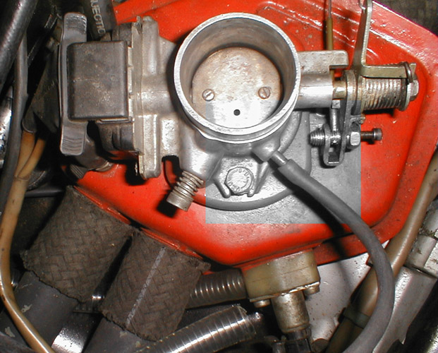

Up untill a few days ago my car was running fine but all of a sudden it started to back fire when I decelerated and starting it became difficult. One thing that has been found is the both the vaccum hoses - light blue and the red to the distributor - both pull vaccum at idle and both lose vaccum when giving the motor some throttle. The red is supposed to have little vaccum at idle and gain vaccum with added throttle - correct? We are thinking that my throttle body has gummed up hole some where but at this moment we don't know how the advance hose nipple is plumbed in the 1976 2.0 throttle body - anyone got any ideas or a detailed drawing of how the advance vaccum flows through it? Thanks, Jim

jimkelly   Well I changed the mps and things are better but n...   Jan 9 2006, 05:06 PM
jimkelly   pic   Jan 9 2006, 05:07 PM

jimkelly   Captain wrote opposite Dave - I had to ask despite...   Jan 9 2006, 05:34 PM
Rand   Gotchya... I have read the factory left it UNplug...   Jan 9 2006, 05:39 PM
Bleyseng   <...   Jan 9 2006, 07:31 PM
Bleyseng   pic   Jan 9 2006, 07:37 PM
Dave_Darling   <...   Jan 9 2006, 07:45 PM
Bleyseng   Lookat the 73 2.0 Throttle body with the two ports...   Jan 9 2006, 07:53 PM
jimkelly   Thanks to you guys my baby is feeling a lot better...   Jan 9 2006, 07:56 PM
