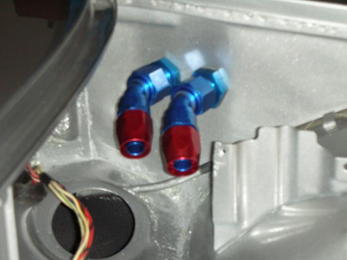

1/7/06 Bulkhead fittings and -12 45AN fittings test fit. I decided to run the oil lines thru here instead of inside the cab. these will snake down next to the wiring harness by the fuel cell in a heat sleeve.
