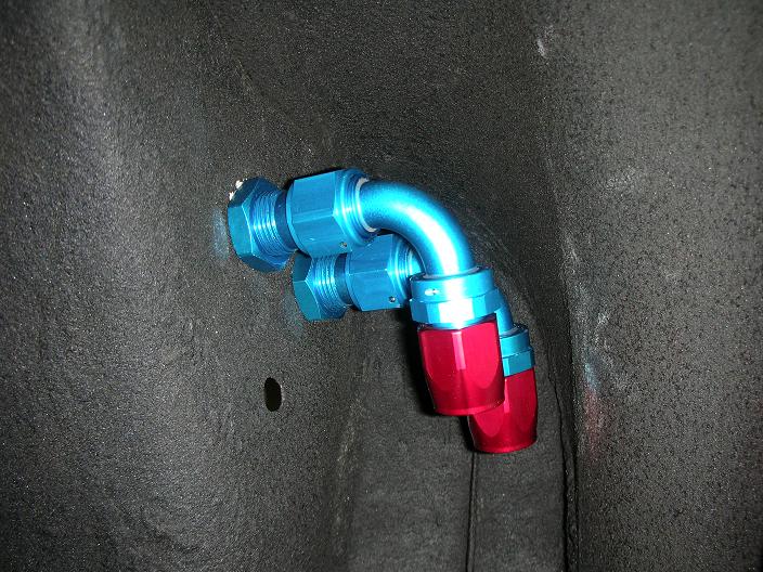

1/7/06 Inside wheel well. -12 bulkheads and AN 90's Small hole is radio antennae wire hole.
