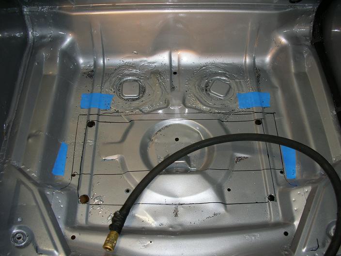

1/7/06 Time to make a big hole.

Marv's3.6six   1/7/06 Time to make a big hole.   Jan 8 2006, 08:47 AM
Marv's3.6six   1/7/06 The biggest cut I have done on a teener 9X1...   Jan 8 2006, 08:50 AM
