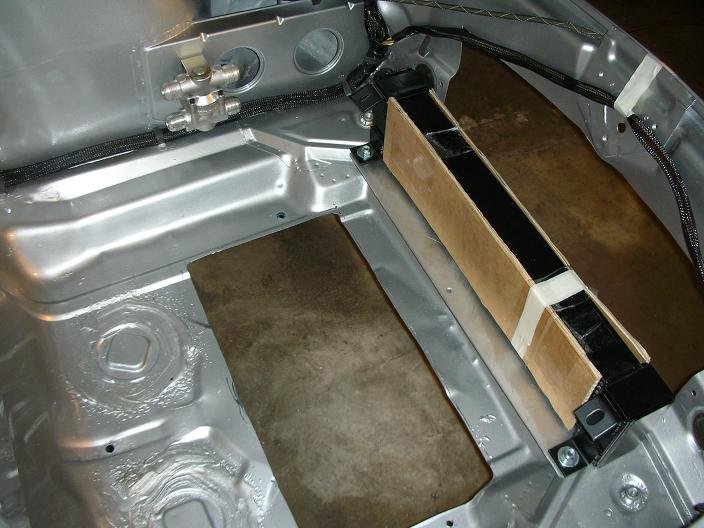

1/7/06 Mount oil cooler to custom fab rubber mount base plate and installed thermostat.

Marv's3.6six   1/7/06 Mount oil cooler to custom fab rubber mount...   Jan 8 2006, 08:54 AM

Marv's3.6six   1/11/06 Oil lines finished in front trunk, top vie...   Jan 12 2006, 08:09 AM
Marv's3.6six   01/11/06 Oil lines lower view, to Tstat.   Jan 12 2006, 08:10 AM
