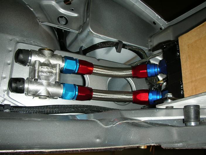

1/7/06 fab custom -12AN lines from oil cooler to Tstat. You can see the rubber isolator mount for the oil cooler base plate on the right.

Marv's3.6six   1/7/06 fab custom -12AN lines from oil cooler to T...   Jan 8 2006, 08:57 AM

brp914   seems like an odd place for the thermostat. the p...   Jan 29 2006, 02:03 PM
J P Stein     Jan 29 2006, 05:25 PM
trekkor   Here's mine. I've seen one mounted behind ...   Jan 29 2006, 06:19 PM
