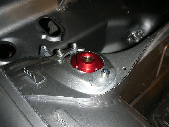

1/07/06 Passenger side mono ball.

Marv's3.6six   1/07/06 Passenger side mono ball.   Jan 8 2006, 08:59 AM
