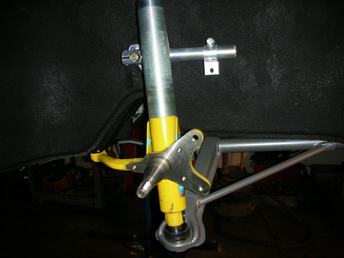

1/7/06 Bilstein RSR drop spindle strut mounted to elephant racing decambered ball joint.
