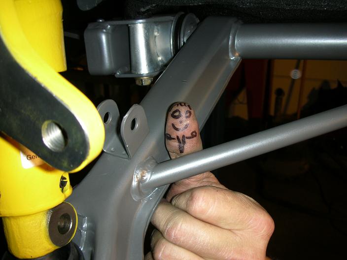

1/7/06 Tom's thumb
Marv's3.6six   Marv's 3.6 GT project thread   Nov 17 2005, 12:08 AM

Marv's3.6six   1/07/06 Passenger side mono ball.   Jan 8 2006, 08:59 AM
Marv's3.6six   1/7/06 Bilstein RSR drop spindle strut mounted to ...   Jan 8 2006, 09:03 AM
Marv's3.6six   1/7/06 Tom's thumb   Jan 8 2006, 09:04 AM
