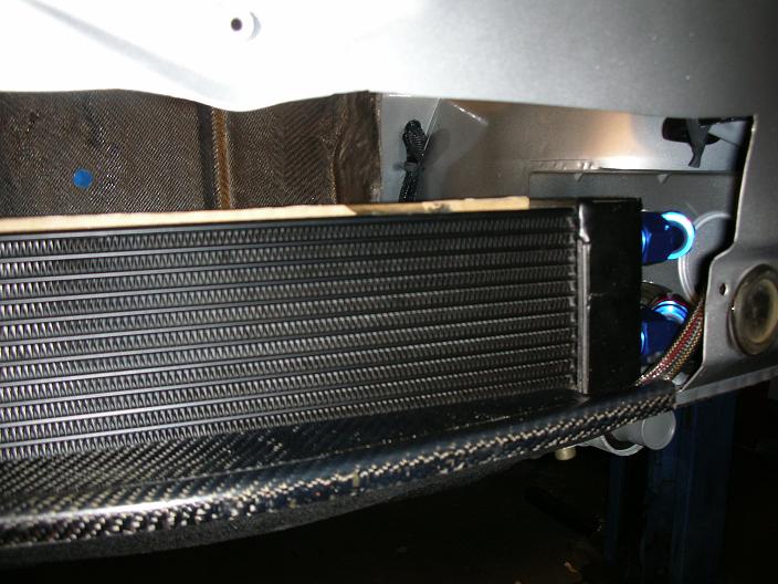

1/7/06 Carbon fiber air deflector test fit.
It does not look like much was done today but we got about 20 hours worth of labor done, lots of stuff not seen like the shift linkage, misc bracketry, clearencing on the tub for oil lines, etc. etc. a very good day!!!!!!!! Its moving along.

Marv's3.6six   1/7/06 Carbon fiber air deflector test fit. It d...   Jan 8 2006, 09:06 AM
