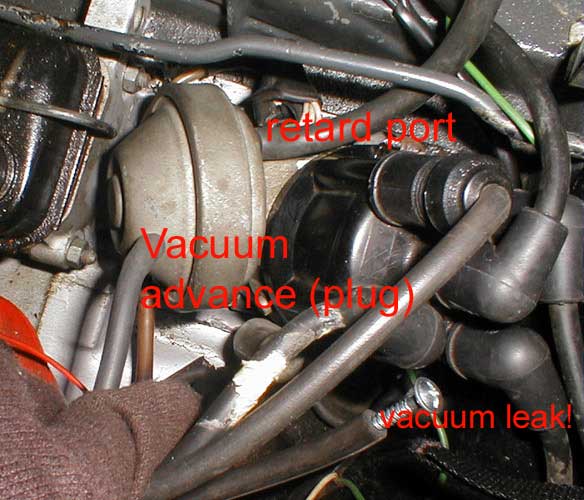

Bleyseng   pic   Jan 9 2006, 07:37 PM
Dave_Darling   <...   Jan 9 2006, 07:45 PM
Bleyseng   Lookat the 73 2.0 Throttle body with the two ports...   Jan 9 2006, 07:53 PM
