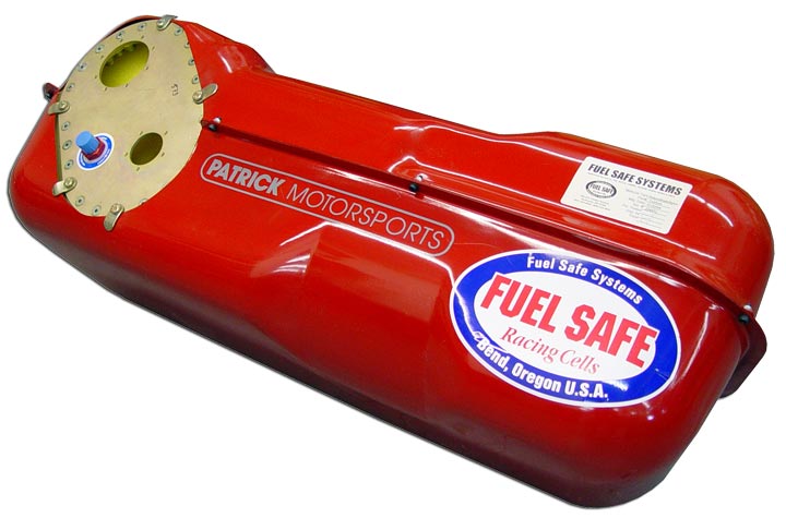

Is the fuel cell going where the old tank was or in the front?
Yeppers, PMS fuel cell go's in the stock location. Although did have to give it a little love on the bottom with a baseball bat to clearence for the oil lines to pass by it. (IMG:http://www.914world.com/bbs2/html/emoticons/ohmy.gif)
