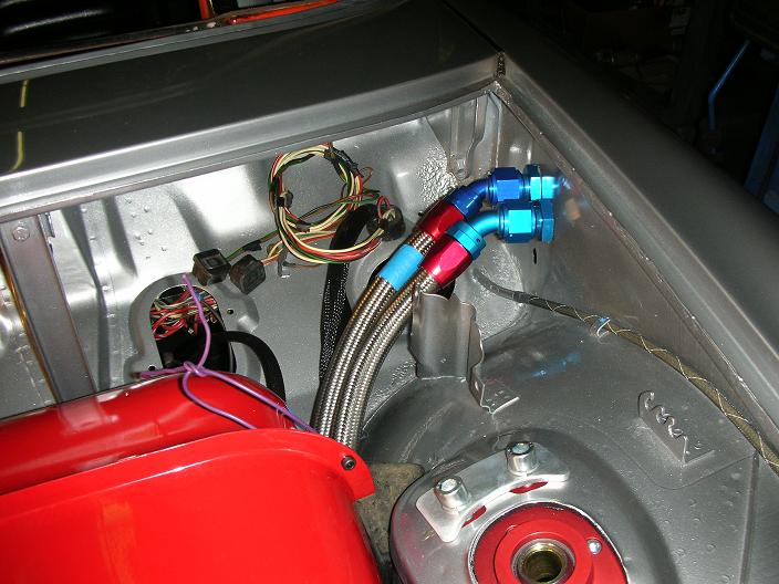

1/11/06 Oil lines finished in front trunk, top view.

Marv's3.6six   1/11/06 Oil lines finished in front trunk, top vie...   Jan 12 2006, 08:09 AM
