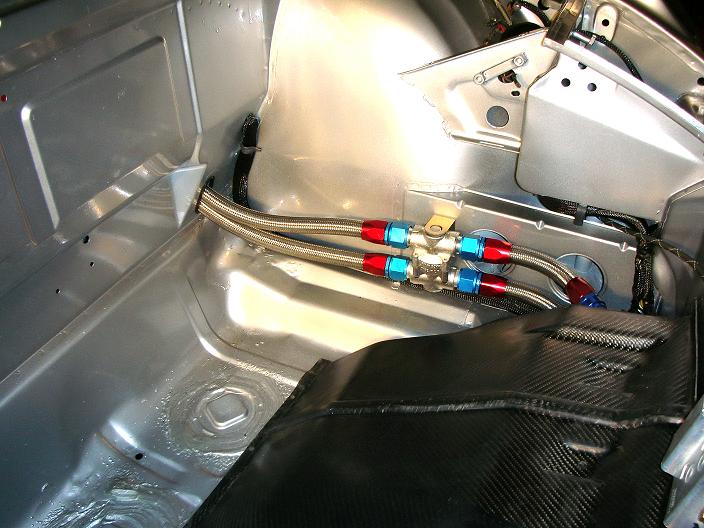

Marv's3.6six   1/11/06 Oil lines finished in front trunk, top vie...   Jan 12 2006, 08:09 AM
Marv's3.6six   01/11/06 Oil lines lower view, to Tstat.   Jan 12 2006, 08:10 AM

Aaron Cox   marv, any worries about the hot oil lines runnin...   Jan 12 2006, 12:00 PM
Marv's3.6six
  Jan 12 2006, 02:44 PM

brp914   seems like an odd place for the thermostat. the p...   Jan 29 2006, 02:03 PM
J P Stein     Jan 29 2006, 05:25 PM
trekkor   Here's mine. I've seen one mounted behind ...   Jan 29 2006, 06:19 PM
