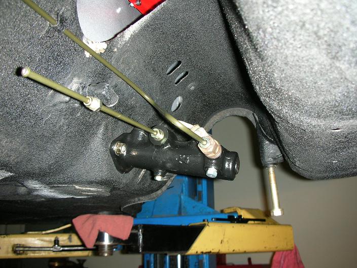

01/11/06 23mm Brake master cylinder install.

Marv's3.6six   01/11/06 23mm Brake master cylinder install.   Jan 12 2006, 08:11 AM
