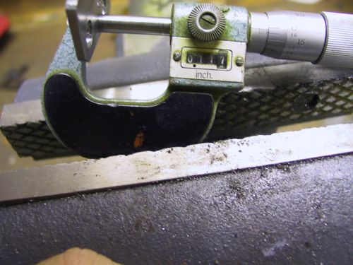

So, I took the spacers from the front calipers that I have, but they're 7.5 mm thick.

I figured it might be easier to simply add a second thin spacer, rather than build a thicker one. Not sure it's going to be the final solution, but I had the thin stock handy. This is really a test piece:
