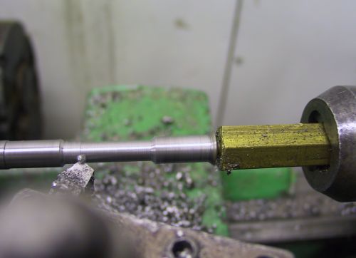

Ok,
I decided to do something a little productive. I was thinking about Eric a couple of times while doing this.
I decided to turn some pad retaining pins. I got one done. I find it's very difficult to take a picture of a piece spinning in a lathe, but here it is.
