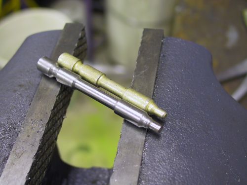

Please be gentle with me if you're going to critique my machining technique. All I know is it results in a pin. Longer just-machined pin next to stock one. Small transverse hole still to be drilled.

michel richard   Eric, okay, okay, I'll do it right. I got yo...   Jan 16 2006, 01:27 AM
