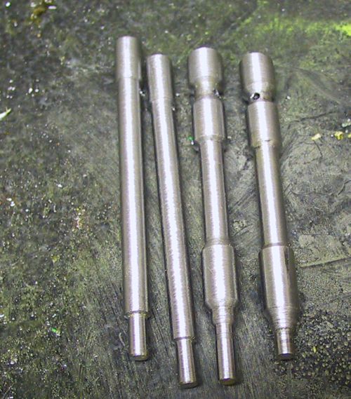

Two things,
1) The hardware store called and they say they can't get any 7mm socket head bolts, any length. I asked if they could get Torx head, or other similar, and apparently not. Oh well.,
2) finished making the pins:

michel richard   Two things, 1) The hardware store called and they...   Jan 17 2006, 08:31 PM
michel richard   And this is how they will look when installed. Er...   Jan 17 2006, 08:32 PM

michel richard   I figured out that the pins that I made with the b...   Jan 21 2006, 01:22 PM
michel richard   And here's what the new pin looks like in the ...   Jan 21 2006, 01:23 PM
