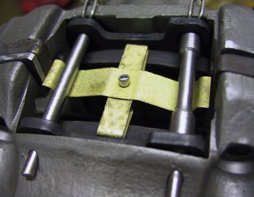

michel richard   I figured out that the pins that I made with the b...   Jan 21 2006, 01:22 PM
michel richard   And here's what the new pin looks like in the ...   Jan 21 2006, 01:23 PM
