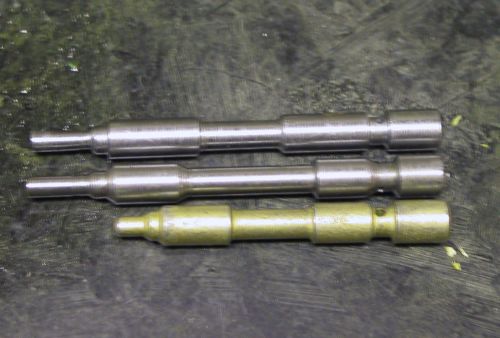

I figured out that the pins that I made with the bosses were not ideal.
It looks like part of the job of those pins is to help center the spreader spring. So I turned another pair with a shorter mid-section.
Here's a picture of an orginal short pin (bottom) my first attempt (middle) and this morning's style of pin. This morning, I made the bosses longer and the mid-part the same length as on the original.

michel richard   I figured out that the pins that I made with the b...   Jan 21 2006, 01:22 PM
michel richard   And here's what the new pin looks like in the ...   Jan 21 2006, 01:23 PM
