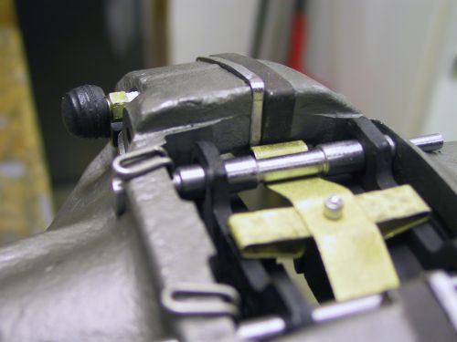

And here's what the new pin looks like in the caliper. Once more, the spacers betwen the caliper halves in this picture are for mock-up purposes only.

michel richard   and bolted up. As far as I'm able to measure,...   Jan 15 2006, 08:44 PM
michel richard   Finally I'll need to turn some longer pad reta...   Jan 15 2006, 08:45 PM

michel richard   I figured out that the pins that I made with the b...   Jan 21 2006, 01:22 PM
michel richard   And here's what the new pin looks like in the ...   Jan 21 2006, 01:23 PM
michel richard   Got my spacers and bolts from Parts Heaven, and I...   Jan 31 2006, 07:44 PM
michel richard   And the calipers, assembled. I still need to get ...   Jan 31 2006, 07:46 PM
