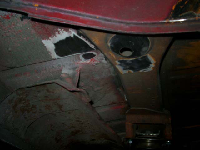

underside, prepped for mounting bracket:

SirAndy   trunk support plate welded in:   Jan 22 2006, 10:43 PM
Howard   Hey Trek, if Andy gets a car that's fast enoug...   Jan 22 2006, 10:44 PM
SirAndy   mounting bracket welded in:   Jan 22 2006, 10:44 PM
SirAndy   McMark welding ... http://w...   Jan 22 2006, 10:45 PM
Howard   Seriously, that is a winner!   Jan 22 2006, 10:45 PM
