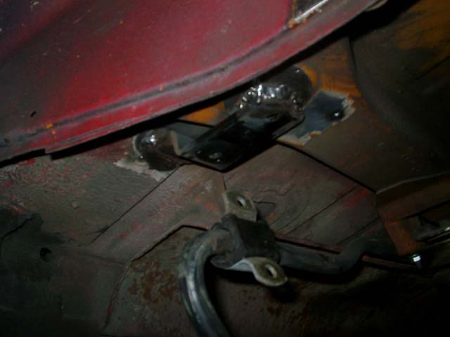

mounting bracket welded in:

SirAndy   underside, prepped for mounting bracket:   Jan 22 2006, 10:42 PM
SirAndy   trunk support plate welded in:   Jan 22 2006, 10:43 PM
Howard   Hey Trek, if Andy gets a car that's fast enoug...   Jan 22 2006, 10:44 PM
SirAndy   mounting bracket welded in:   Jan 22 2006, 10:44 PM
