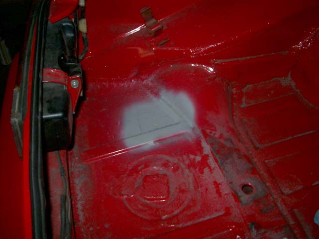

alright, time to start a conversion thread. i picked up the engine a month ago and started with the prepping of the tub today.
didn't get too much stuff done, oh well, babysteps ...

after metal ready and primer ...

SirAndy   underside, prepped for mounting bracket:   Jan 22 2006, 10:42 PM
SirAndy   trunk support plate welded in:   Jan 22 2006, 10:43 PM
Howard   Hey Trek, if Andy gets a car that's fast enoug...   Jan 22 2006, 10:44 PM
SirAndy   mounting bracket welded in:   Jan 22 2006, 10:44 PM
SirAndy   McMark welding ... http://w...   Jan 22 2006, 10:45 PM
Howard   Seriously, that is a winner!   Jan 22 2006, 10:45 PM
SirAndy   after metal ready and primer ...   Jan 22 2006, 10:46 PM
