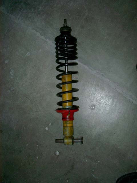

i also replaced my old 180lbs progressive springs with new 250lbs springs on threaded collars.
i'm running bilstein shocks ...
here's the old 180lbs springs, man those are LOOOOOONG: (IMG:http://www.914world.com/bbs2/html/emoticons/rolleyes.gif)

SirAndy   we had some fitting problems on the bilstein shock...   Jan 22 2006, 10:56 PM
SirAndy   this shows how much of the top rubber needs to be ...   Jan 22 2006, 10:57 PM
SirAndy   here you can see the part of the top mounting piec...   Jan 22 2006, 10:58 PM
SirAndy   and done (sans the top rubber):   Jan 22 2006, 10:59 PM
SirAndy   perfect fit! http://www....   Jan 22 2006, 11:00 PM
