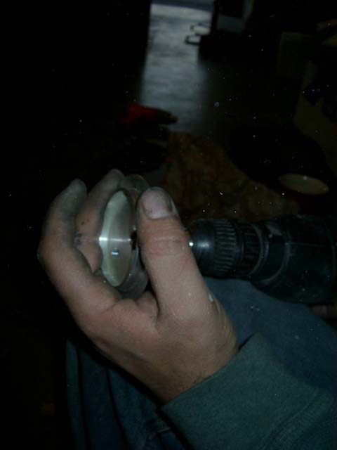

we had some fitting problems on the bilstein shocks. the problem was that the top aluminum spring plate is obviously designed to work with koni shocks.
the center hole for the shockshaft was too small and the top of the plate has a ~1/8 "hump" that will result in not enough thread to secure the nut on top if you use the stock rubber pieces.
we found a workable solution by cutting off about 1/8 of the top mounting piece that is usually screwed on the shaft and holds the lower rubber spacer.
then, we took off the same amount (~1/8) off the top rubber and voila! we got enough thread to fasten the top nut!
here is mark honing out the center hole, using his "special precision" shop equipment: (IMG:http://www.914world.com/bbs2/html/emoticons/biggrin.gif)
