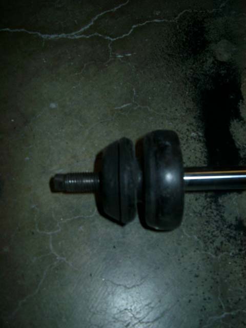

this shows how much of the top rubber needs to be cut off:

SirAndy   we had some fitting problems on the bilstein shock...   Jan 22 2006, 10:56 PM
SirAndy   here you can see the part of the top mounting piec...   Jan 22 2006, 10:58 PM
SirAndy   and done (sans the top rubber):   Jan 22 2006, 10:59 PM
SirAndy   perfect fit! http://www....   Jan 22 2006, 11:00 PM
