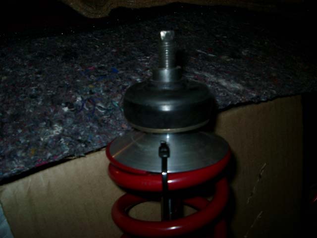

SirAndy   i also replaced my old 180lbs progressive springs ...   Jan 22 2006, 10:48 PM
SirAndy   and here's the new stuff, bling bling ...   Jan 22 2006, 10:50 PM
Scott Carlberg   DAMN Andy, er, SirAndy, planning on going to th...   Jan 22 2006, 10:50 PM
SirAndy   we had some fitting problems on the bilstein shock...   Jan 22 2006, 10:56 PM
SirAndy   this shows how much of the top rubber needs to be ...   Jan 22 2006, 10:57 PM
SirAndy   here you can see the part of the top mounting piec...   Jan 22 2006, 10:58 PM
SirAndy   and done (sans the top rubber):   Jan 22 2006, 10:59 PM
SirAndy   perfect fit! http://www....   Jan 22 2006, 11:00 PM
