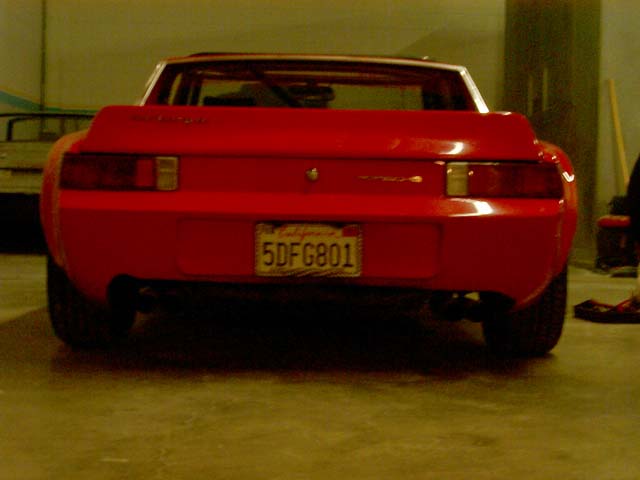

last for today, butt shot after adjusting the ride height ...
5" in the front, from bottom edge of floor pan
5 1/2" in the rear, from bottom edge of floor pan
trekkor took a quick ride around the block with me, the 250lbs springs feel great!
better actually than my old 180lbs. (IMG:http://www.914world.com/bbs2/html/emoticons/blink.gif)
i'm happy! (IMG:http://www.914world.com/bbs2/html/emoticons/boldblue.gif)
