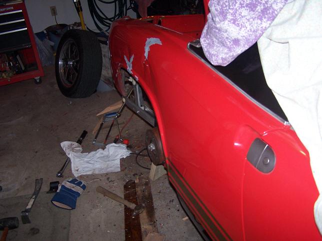

I've decided to keep my wrecked red car until my new 74 2L 914 from Part Pricer is road ready.
I just needed to pound out a few dents to get Big Red back on the road.
Here's a couple of before pics.

Here's some pics now. I don't have any special repair tools, just one heavy sledge hammer, a 20 oz hammer, some small body hammers and dollies, and an Audi scissor jack.

Part Pricer   Nice work. A little bondo and some touch up paint ...   Jan 23 2006, 12:39 PM
Kargeek   Nice work! I have done a lot of body work over...   Jan 23 2006, 01:24 PM
bondo   Dang, I'm impressed. I've got a porta-powe...   Jan 23 2006, 01:25 PM
John Kelly   Nice job! John www.ghiaspecialties.com   Jan 24 2006, 07:34 AM
