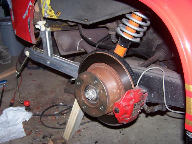

I've decided to keep my wrecked red car until my new 74 2L 914 from Part Pricer is road ready.
I just needed to pound out a few dents to get Big Red back on the road.
Here's a couple of before pics.

Here's one way that I've used the Audi jack. In this position, the jack was able to pull the fender out quite nicely. I think the fender is still about 1/2 inch lower than the driver side, but it's getting close.
