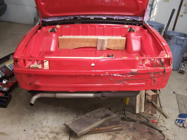

From the back, the trunk is starting to look like it did before. First I'm getting the metal to the right position, then I'll work it to get it into shape.
The wood in the back of the trunk was used to support the Audi jack when pushing the back end of the car back into shape.
