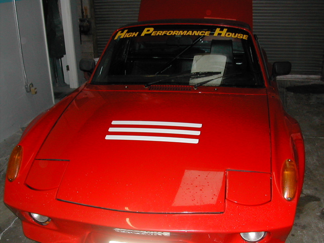

mark and i scratched our heads long and hard (mine was easier cuz i don't have nearly as much hair as he does) and we came up with a concept for the front mounted oil cooler and the "out the hood" venting of the hot air ...
first, i'd like to mention again that i "hate", yes hate, the idea of dumping any significant amount of additional air under the car. (IMG:http://www.914world.com/bbs2/html/emoticons/icon8.gif)
i don't care if that's how the factory did it. their solution was quick & dirty as they were planning on racing the GTs in '70. they obviously did what got them results quick and without too much work.
additional air under the car *will* create additional lift, especially at higher speeds.
soooooo, i'm opting for a "out the top" solution.
but i also hate those big ass holes in the hood, so i'm going for a more stealth approach.
louvers!
here's a vinyl mockup of where the louvers will be, once painted in body color, they'll be hardly noticeable, but *very* effective! (IMG:http://www.914world.com/bbs2/html/emoticons/smash.gif)
