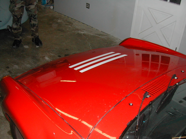

SirAndy   more "babysteps" ... got off to a slow start, did...   Feb 4 2006, 11:03 PM
SirAndy   took like 2 hours to get the two sides separated ....   Feb 4 2006, 11:04 PM
SirAndy   mark convinced me those would be much nicer all cl...   Feb 4 2006, 11:05 PM
SirAndy   and then some primer, so they don't turn into ...   Feb 4 2006, 11:08 PM
SirAndy   time for some http://www.914w...   Feb 4 2006, 11:08 PM
Aaron Cox   tell us about your hood louvers.   Feb 4 2006, 11:09 PM
SirAndy   ...   Feb 4 2006, 11:12 PM
Aaron Cox   curious in your method... cut 3x, fold 2x..... ...   Feb 4 2006, 11:13 PM
SirAndy   ...   Feb 4 2006, 11:26 PM

jonwatts   I like the louver idea, but your air funnel looks ...   Feb 6 2006, 09:44 AM
